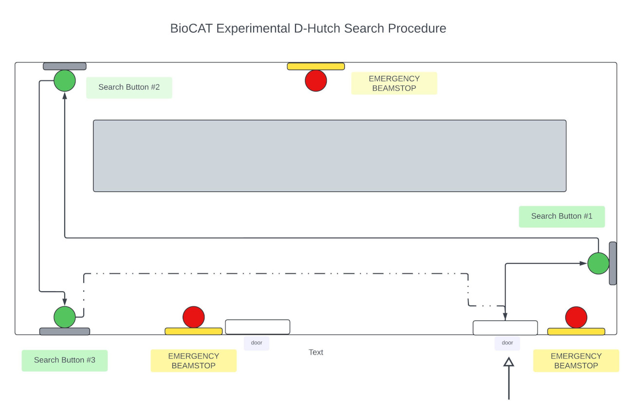

Searching the D-Hutch
Before the shutter can be opened and X-rays can be introduced into the D-hutch, you must clear the hutch of all people and one person must complete the Hutch Search Procedure to make sure that all people have been vacated from the hutch.
You should always be in communication with the people you are working with inside of the hutch. When you are ready to close the hutch door, ask if all of the people also inside of the hutch are ready to ‘close the hutch.’ If they are not ready, wait until they are. If they are ready, you may begin the hutch closure procedure.
Once everyone is ready, please ask everyone to leave the D-hutch and then you may begin the Hutch Search Procedure. There are three green search buttons that have yellow flashing lights inside of our hutch which are spaced in such a way that you must walk the length of the hutch in order to make sure that no one remains in the hutch once it is closed.
The hutch search buttons are numbered, and you must push them in the same sequence every time 1-2-3. If you encounter anyone in the hutch while you are doing the Hutch Search Procedure, you are to ask them to leave the hutch or stop the hutch procedure. Once you have completed the walk-around, cleared the hutch of all people, and pushed the 3rd button, you may leave the hutch.

Emergency Beam Stops
Our experimental hutch is equipped with 2 emergency beam stops. These are to be used in the unlikely event that you should be locked in an experimental hutch. This should never happen and it is forbidden for someone to be inside of the hutch with the door closed!
However, in the event that an accident has occurred, pressing the red mushroom button while the shutter is open will dump the storage ring, and stop the X-ray beam.
The door can then be opened by pressing the top button on the auxiliary door control panel(to the left of the entry door), and holding for three seconds. If the door does not open with a press of the top button, press the bottom button to disengage it from the pneumatic system. You can then open the door manually.
If an emergency beam stop is inadvertently pressed while working in the hutch, it will not dump the ring, because the door will be open, and the shutter closed. However, it will disable your search boxes (see above), and must be pulled out in order to perform a search of the hutch.
